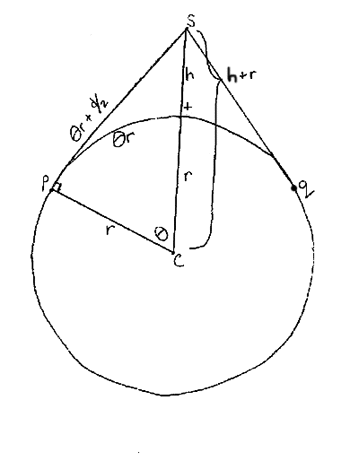

If we pull the belt up at a point, we get a height h meters above the earth's surface. To determine this height , we begin by constructing a sketch of the earth with its center at c. The belt is tight against the Earth for most of its circumference, but at some point p leaves the Earth's surface, traveling up to the apex s, and returning to the Earth's surface at point q.
  • Draw the line segments cs and side cp, and let be the angle formed between them, expressed in radians. Also, let t denote the point at which the line segment cs intersects the earth. The arc that lies on the earth surface connecting p and t has length . (This is because the circumference of a circle with radius r is and an arc that spans radians spans of the entire circle.)
  • Next draw the line ps connecting p and s. This line is formed by using the portion of the belt that would lie on the arc connecting p and t plus one half of the slack in the belt; thus its length is
The length cp, is r, the radius of the earth
The line segment cs, has length r + h (radius of the earth plus the unknown height). Since the line segment ps is tangent to the Earth's surface at point p, the three lines form a right triangle.

We can use high school trigonometry (yes, it's really good for something) to compute the other angles and the length of the third side of the triangle.
We first find by solving for in the following equality.
This can then be solved accurately by computer computation using special mathematical software. Our software found that
radians.

This value of theta is then used, together with the trigonometry formula,
and some simple algebra to compute h = 402 meters.
