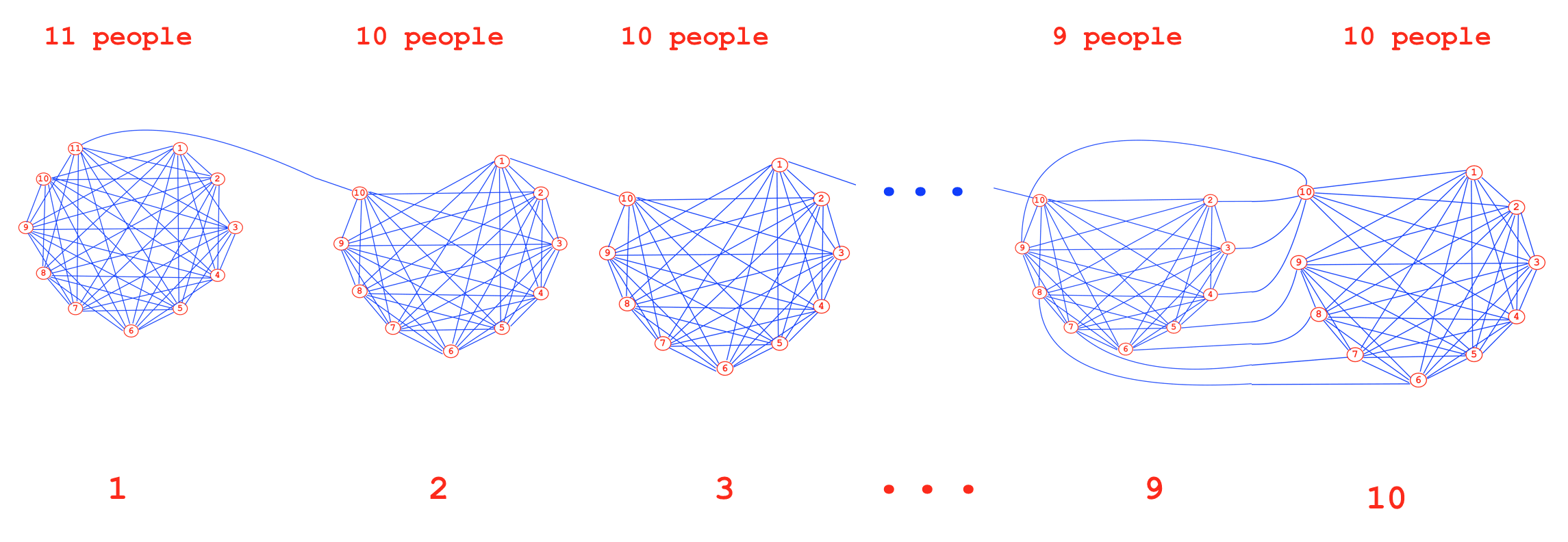

The idea in this challenge is to connect a chain of (almost) cliques and carefully make the graph nine-regular.
As an example solution, we present here the drawing of Alper Halbutogullari (thanks!).
